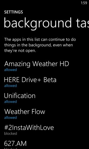

razor1973
Aug 16, 2008
49
Visit site
No, no, I'm very disciplined and always block rogue apps that think they should be running in the background. I never have more than 5. See attached. This has been happening for months, so I've obviously rebooted many times. No luck. :cry:

ChMar
Mar 15, 2013
273
Visit site
I have apps like Weather Flow and Amazing Weather HD configured to work in the background on my AT&T Lumia 920, but they never do. They never update my live tile until I open them again. I've tried blocking them and then allowing them again, uninstalling and then reinstalling them, ... Nothing works. Is this a common problem and is there a solution for it?
Apps in the background need arming first. So after install you need to launch them from start screen.
Now any working background agent can crash(due to various reasons). If crash occurs then it will get marked as bugged. Happens again and then it will not run in background until you rearm it.
I don't know but maybe due to some connection issues those apps crashed in the background for you and were banned from rearming every 30 mins. If that is the case just realunch them from start and they will be rearmed in 30 mins.
razor1973
Aug 16, 2008
49
Visit site
Done that many times too. I've actually blocked them, then allowed them to run in background next time they run and run them again. I've even rebooted at this point and nothing, days later, weeks later.
