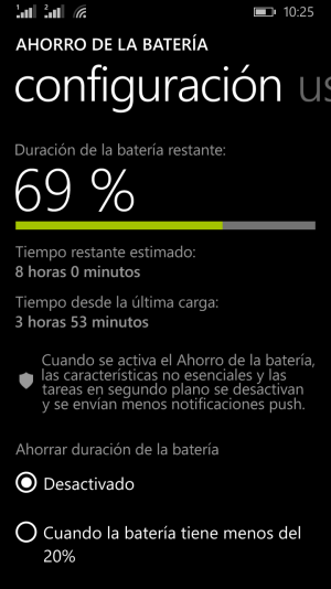

Hello long time lurker here, I been following this amazing community for a while and hoping you guys can help me with my phone, I got my phone in Christmas update it to developers preview same day I bough it , my problem is battery drains real quick doesn't matter if I'm using it or not I think it drains way faster in standby that it does in use, I been reading all this praises for the battery that it last days ..i wish that was my case ! I'm desperate here done two hard resets and still no dice ..Also my phone gets real hot in standby mode not sure what is causing all this madness.. Am I the only one the gets this horrible battery life? Please help.

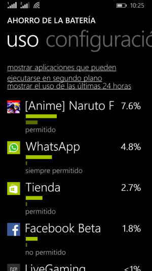

Battery saver > usage. Select "view items that can run in the background" and "show usage from last 24hrs".

I been trying to find the problem by turning off celular data and airplane mode location off and most of the apps turn off the background data in battery saver ..still no dice neither of those are the problem get about the same drain.. So is frustrating I'm thinking that maybe has to do with a non optimized firmware for the snapdragon 200 or maybe blu is to blame..i don't know maybe it doesn't go to sleep mode and all cores work 100% in standby mode maybe that's the heating problem source...I'm thinking too much ..

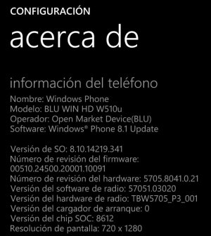

Do you have Preview for developer ON? Any official update? What's your firmware and OS version?
np on battery life here, the only different is my version is 8.10.14203.306 official version.
Taking a look at battery usage WhatsApp is hogging the battery. Also, when it reaches 4% cellphone will shut down.
Did a hard reset, installed Skype, Facebook, FB messenger, Windows Central App, Twitter, Instagram; I decided not to install WhatsApp, battery lasted for 12 hrs and remained a 10% of battery. So I guess WhatsApp was hogging all the juice. I'll try to be without WhatsApp for a week and post results later.
