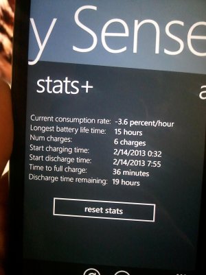

After the Hard Reset, disable back up, restore, my battery life seems to b stabilized. Most importantly, the constantly device warm issue is gone. Touching the back of the phone and feeling cool gives me assurance the device is not running amok..
I tried posting earlier, was distracted by work.
Previously, my phone, according to Battery Sense, was consuming between -22% to -11% per hour idle. After the applied procedure, power consumption has been at a high of -11% per hour to as low as -1.1% per hour, with the average being around -2% per hour with use.
I am thinking Back up, Restore is the culprit. I does not show up in your idle process and is configured on by default.
