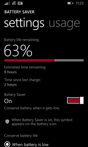

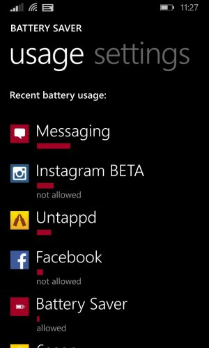

Huge decline in battery life. At first, I credited it to playing around more, but it's at 63% less than 4 hours after unplugging it from a full charge, and all I've done so far this morning is about 8 total text messages (both directions, no pictures) and fire up Instagram BETA for a couple minutes. I have just about everything "not allowed" for background tasks.

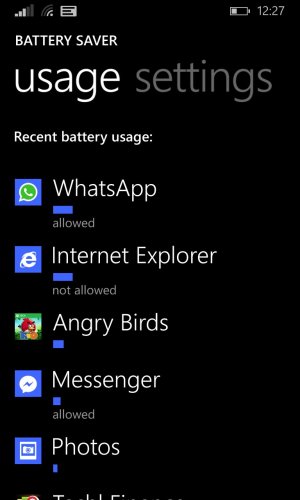

Here is battery usage again after several hours from the previous post.

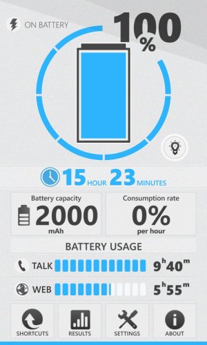

My Lumia 1020 battery life has been consistent until now. I had initial drains and I did the following :
1) Let the phone battery drain completely and then recharge
2) After 100% recharge, I soft reset the phone.
Until now, below is the battery performance. The battery life is consistently at 15 hours per day

That's a crap load of battery time, what phone are you using?
I'm going to take your tip and use the adapter to charge my phone after a complete discharge...We'll see if it works

I am using Lumia 1020 as my main phone.
The other phones are Lumia 920 and 625. Will post screenshots of both phones soon.
