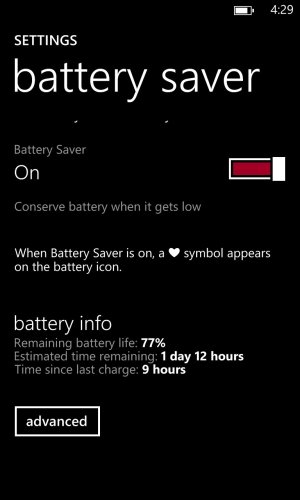

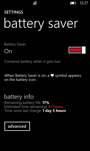

here's a phone after a full discharge

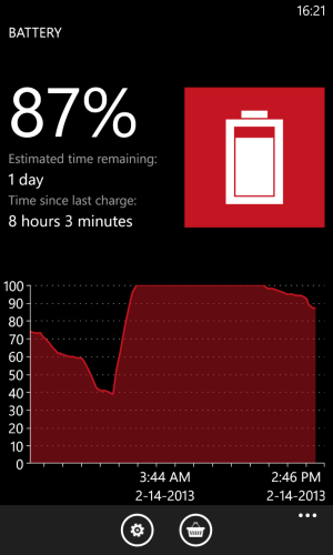

phone today after nightly charge and full day on battery. OK I admit had only a few calls and a minimum of surfing
I'm sure there are days when drain will be heavier... but when I don't use my often, I would expect to come home with a phone at least still 50% charged.
so my advice is if you experience drain, try disabling apps that run in background or apps that are setup to receive notifications. It could very well be one of these. Don't blame the phone directly, nor the OS running it

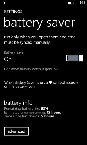

Just checked my phone (been at work for 5.5 hours) and my battery life is horrible:
BTW: notice my phone has even been in Airplane Mode without WiFi..... and it's STILL dying!!!! Also, I don't have a single app with background running permissions enabled.

Sounds a weird question but... do you make many voice calls?
