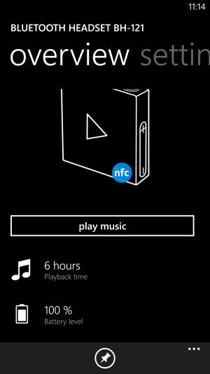

Paired with my L1520 via NFC simply.
It shows up in Settings/Accessories too.

Is this headset supporting Bluetooth 4.0 ? And how many hours of playing songs does it last ?
The packaging states Bluetooth 3.0 and the Accessories app shows 6 hours music play back. It has just arrived so I cannot say if that 6 hour estimate figure is correct.

It has just announced to me 'Battery low' and then about 10 mins later it switched itself off. I didn't time my listening sessions, but I will have easily got 6 hours out of it. So, the quoted times seem spot on.

One last thing. Pinning the BH-121 from within Accessories, gives you a nice live tile showing the battery level and also if the headset is connected or not. As soon as I switch off the headset, the live tile changes, so it's not subject to the 30mins max update schedule like other apps.
