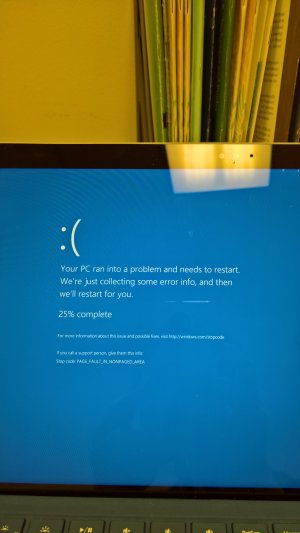

Happened twice already, might try again when I get home.... But yeah this screen showed up at the last step of the update at about 85-88%. Then the machine restarts and restore to previous build perfectly (phew) but still pretty disappointed about this.
Anyone else having the issue?

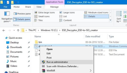

You can easily convert the Install.esd file from the hidden $WINDOWS.~BT folder on your windows installation drive where your build has been downloaded through Windows Update. That is if your Windows is installed on C drive then the folder is at C:\$WINDOWS.~BT and the required Install.esd file is at C:\$WINDOWS.~BT\Sources. Make it visible by checking the Hidden items option in the View tab of File Explorer ribbon (You probably might be knowing about it, but still).
It's super simple. Get the step by step guide here:- https://www.techjourney.net/decrypt-convert-upgrade-esd-to-create-bootable-windows-iso-or-wim
After creating the ISO, you can double click to mount it and run the setup.exe from the mounted disk drive\setup.exe and manually update to the latest build.

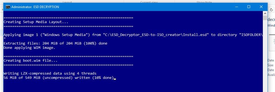

That shouldn't have happened. What program did you use? Download this one from my OneDrive and try again with it (which I had used):- https://onedrive.live.com/redir?res...59262&authkey=!ABMT5PnafG8_uQk&ithint=file,7z
These are the scenarios you should come across during the process:-
