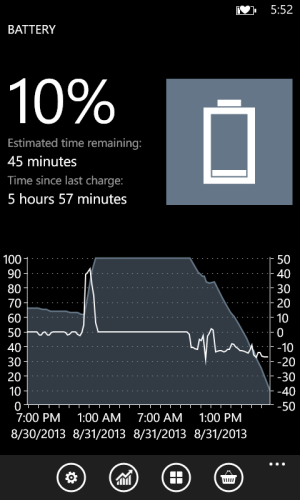

I played some music for 20 minutes in the car, which the phone was being charged during that time. Otherwise IDLE, doing nothing but being in my pocket.

I never get an accurate representation of my battery life because the settings and my favorite battery app both just show some crazy 5-7% discharge rate even when I'm not using phone much. After 1-1 1/2 hours of listening to music in still at 100% and usually during classes for another hour of not using it im on 100% while it still say 5-7% per hour. I end the school day with around 85-90% depending if I played games on the bus him from school(only listen to music in morning because to tired for games.) I also use battery saver the whole day, and just want to know if the inaccurate discharge rate is just me.
