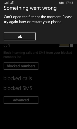

Since I updated to wp8.1, every time I try to open Call+SMS filter on my Lumia 810, I get this error message
Anyone else get the same message? If so, have you figured out the problem?

Thanks for the suggestions :)
It didn't work though :(
No one else seems to have this issue, it must be something wrong with my phone I guess.

No, this has been reported by previous posters. I got the error, and still have, from when I tried the uninstall trick from your link. I'm guessing updating with a hard reset is what will cure it, but I've no need to reset just yet. I'll wait and see if a bug is removed under the full 8.1 release.

I was getting the same error also. Mine would occur with the Call+SMS Filter and also the Info Settings. I don't remember if it was the 8.1dp second update that fixed it, the app updates after the 8.1dp was installed, or a few soft resets.
Mine were throwing errors for about 3 weeks and didn't seem to effect the phone in any way, so I just ignored them. I would try to check for an update for 8.1 or for the Call+SMS Filter using SysApp Pusher in the store.

Does this app even work? I'm on Verizon & I have set this up after each update hoping it would work. It never does - is this carrier specific?

@sicnus, yes this app does work. I got my phone reflashed last week and it's all present and correct. Even after the update, still working.

TYVM, I'll give it another try. I also found out it won't block anything in ur contacts, didn't know that

I had that same error message previous to 8.1. It never worked once on my 920. But once I got my 1520 and flashed 8.1 it has worked like a charm. Not sure what the issue was to be honest. Just glad it's not happening anymore.

Appears to be working now! Now I can - consider - deleting my dummy contacts with special silent rings for telemarketers!

call+SMS filter app not working give the massage " That didnot work, through it's not clear why .Try it again."

I also have the problem. My phone had problems and was flashed at Microsoft customer care office last week. When I got it back, the call and sms filter were no longer working and I need to block so many intrusive numbers. Any help yet?

The following works on Lumia 920 according to forum on microsoft
"On my Lumia 920 this did the trick
1. I changed date to 2120, then uninstalled Call+SMS Filter
2. changed date back to today, then re-installed Call+SMS Filter from https://forums.windowscentral.com/e...2Fcallsmsfilter%2F9wzdncrfj3jf&token=oeDRnuLU
3. there was no change - Call+SMS Filter still failed to open
4. then I installed Extras & Info https://forums.windowscentral.com/e...p%2Fextras-info%2F9wzdncrfhw5x&token=D7yMsq_m
5. Soft rebooted
6. Call+SMS Filter now working! (after 12 months, finally got it working)"
