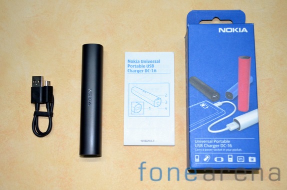

If the phone manage the charge rate, not the charger, then how come if you charge using the wall charger, the battery will fully charge faster than if you charge using the USB port from your computer?
The charger that comes with the phone charge with output current of 1 A, while charging using the standard USB 2.0 port will give the output of 500 mA (if none other devices are connected to the other USB port)
And even the Nokia DC 16 portable battery has the output of 950 mA.
This can be easily proven by doing the testing. If you use the wall charger of 1 A compared it with the charger that output 2 A, the one with 2 A will definitely cause the phone to heat up more. And in the long term it will reduce the battery life.
And this has been proven by my college friends who did this kind of battery testing. Not only that, in a real world example, people in my country like to use the power bank, that charge the battery at 2 A. And all of them complained that their battery life do not last as long as it used to.
