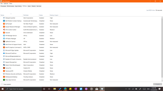

Can you also tell us what your startup list looks like and if you go to Task Manager > Performance > Resource Monitor, how does it look?

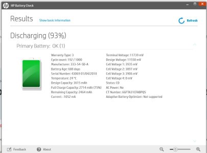

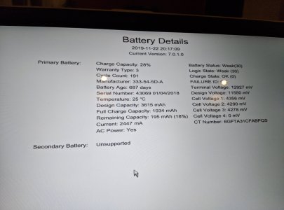

Couldn't find this info in Windows generated summary, but got this from HP Support Assistant:

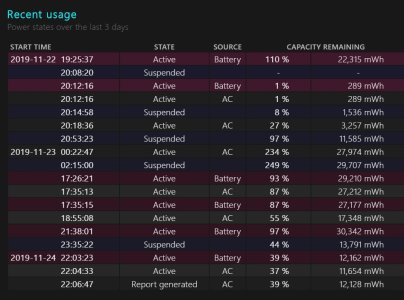

It would help if we could see the cycles the battery made (/c&p the day to day data from the Windows Battery Report).

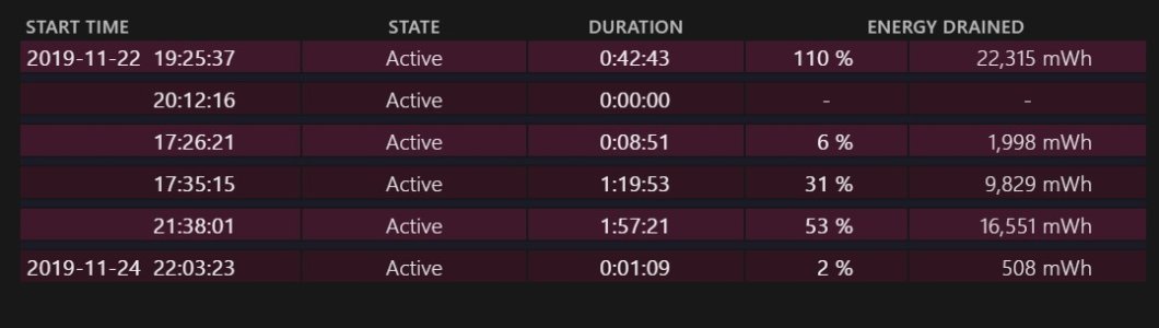

Regarding the battery report, here it is:
CHEMISTRY LION
DESIGN CAPACITY 30,342 mWh
FULL CHARGE CAPACITY 30,342 mWh
CYCLE COUNT -
