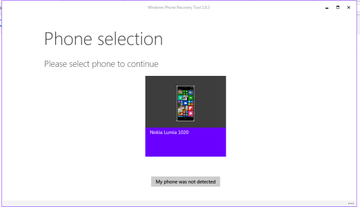

Guys help me, I have similar problem
As you can see, my phone is recognized my WPRT

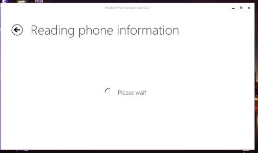

but after that it is stucked at this step
I tried everything, changing usb ports, cables, reinstalling everything that has with nokia, reinstalling WPRT, but nothing
this is my first time with windows 10, I thouhgt it is going to be much stable build comparing to previous one, and yes, I am aware of that, this is technical preview and it is not for daily usage, but I didn?t know that I would have this problem with rollback to WP8.1
Have you tried waiting lol. It took hours for it to read my phone information first
I had the same problem. I did a software phone reset. .and then when it was done, I immediately used the recovery software and that worked for me
Performs factory reset then try again with Windows Phone Recovery Tool. Just do not restore backup after factory reset, even no need for sign in.
yes, i?v done this right after installed windows 10, but i guess i have to do this again
