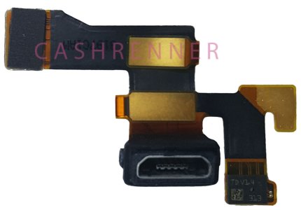

Hello, I need help, charging problem on 1020.
The phone vibrates many times during charging - connection problem.
I have tried another charger, another cable, same problem.
Is there any way to change the connector without changing whole housing?
Thanks for answers.

Actually the video does show you where the charging port is. The second vid (link) goes more into detail..
You're looking for sth like this: Nokia Lumia 1020 Micro USB Connector Mic Charging Port Charger Dock Flex Cable | eBay
As you can see it isn't connected to the housing. I recently changed the charging port of my 920
