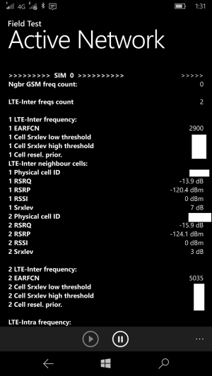

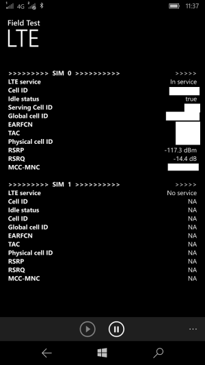

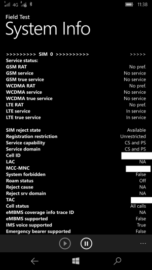

Just an update.... I guess 4G does mean LTE????? I loaded up the Microsoft Field Test app, check these screenshots out....
Notice that the notification center says 4G... When you swipe down it says "Rogers 4G"... But LTE field test menu shows this...

Well, some more info...
While I'm kind of a n00b when it comes to cell technologies. Someone correct me if I'm wrong in the following statement:
EARFCN 2900 is ~2500-2600Mhz
EARFCN 5035 is ~700-735Mhz
Therefore, my phone while passing data was active on LTE Advanced (using multiple spectrums of LTE)?
lol
EDIT/ADDITION: I'm an *****... Dual SIM 950 XL only supports LTE Category 4 (not LTE Advanced), only the Single SIM supports LTE Category 6 which is LTE Advanced... lol
The list above was just listing off "friendly towers" intra/inter means different towers on same frequency or different frequency (not sure which is which with inter/intra)...
