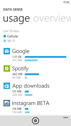

I've been getting horrendously bad idling battery drain on my HTC8X, so bad that I drop down to around 30% after charging only 5-6 hours ago and with barely any usage. I used to get over a days worth of a full charge with pretty decent usage. I have only Amazing Weather running in the background, and Gmail to sync every 30 minutes (I think). I say I think, because I can't even access my sync settings. Today I noticed that in Data Sense, Google is using a ton of data; further, I can't access my sync settings because it says that Google is constantly syncing! Have a look below, do you agree that this data usage is very excessive? What can I do to fix this since I can't even access my sync settings?

I couldn't even uninstall and reinstall because it would start syncing right when the phone booted. Finally I was able to catch it; it was set to 15 minutes, but as shown, it is using a ton of data because it is seemingly always stuck syncing, more or less. I uninstalled it and set it to manually sync, so let's see if that does the trick.

I can now confirm that this was indeed the issue. I've barely dropped at all from a full charge earlier today; let's hope it does the same tomorrow.
