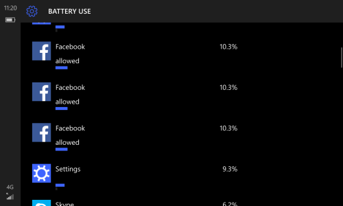

I don't think it's a faulty battery, rather a bug with .107 I have this issue and it occurs when the phone has been used for a good while be it web browsing, reading windows central, playing a game etc.
Use phone for a good while until it gets slightly warm, soft reboot, power down and you will either have a dead phone, less charge or miraculously more charge than had you before. I believe either the background agent that monitors the battery has a bug or if it's tied into the battery saver app then that is buggy. Here is an example (I noticed it when I was on the grocery run):

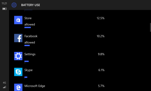

Close the battery saver app and go back it's normal:

To TechFreak, why do you have so many separate facebook icons in your battery? I only have facebook and facebook beta.
It's true but when you did a soft reset if your feedback and diagnostics is set to full it will send data back to MS. you can open a feedback thread or look for others that have the same one and upvote. Not much else you can do after that. I would err on caution because if it is doing something to your battery it may kill the life of it much quicker. I wouldn't like that.
