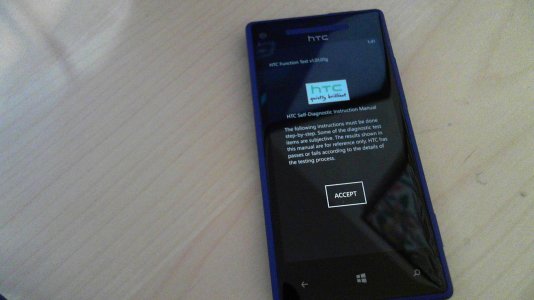

Diagnostic Menu on the HTC 8x

This one brought up the tests for the flash, LEDs and vibrate. The one in the first post brought up radio tests and something else I didn't want to mess with as I didn't understand it. It lets you test 1x, EVDO and GPS radios, giving you detailed info on signal strength, channel etc.
Yeah, on my Verizon 8X it brings up a screen labeled EmbeddedTool. It has two selections available, one is Diag, with a couple settings I don't really understand, and FieldTrial, which gives me the radio options. I now have an app called DiagnosticTool that, when selected, gives me a screen with my MEID, IMEI, SIM ID and VERSION. I can't do anything though, it's just the info.
Yeah, on mine (o2 uk) ##634# aka ##MFG# and ##3424# aka ##DIAG# are the same menu. Different 8X's seem to have different settings though!

##778# brings up the Verizon PST servicexmwnu which allows you to change a host of settings. Its the one the service techs use. I'd advise not fooling with it unless you know what you are doing.

CSDIAg could be starting by using these codes
##634#;
##778#;
##786#;
##3424#
with the last update it has much better tools to test your phone.
