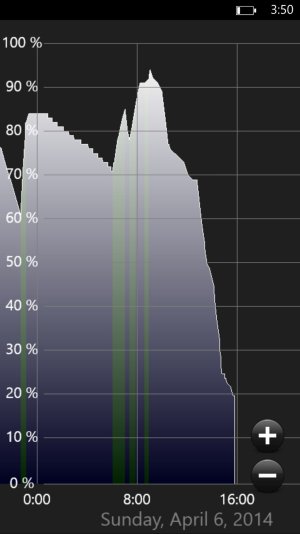

Here's a graph of my battery app reporting the status of the battery from yesterday.

such quick drains usually point to a defective battery.. yeah it may improve a bit in time but u wont really get the full potential what u would have got from a normal one..i suggest u try for a replacement.

Thanks, I did a hard reset and I'll be playing with it today, but that's my thinking. Its defective and I want to get the ball rolling on a replacement. I'll be calling VZW this morning.
