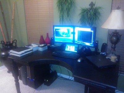

I have dual monitors connected and it works great. I have my Surface standing up behind my keyboard and centered under the two monitors to the touch screen is right near my fingertips. For charging, I just connect the regular charger cable which is not a problem in my case. Though, I can see how you would want both cables on one side or a single cable if you want to use it as a writing surface. USB doesn't carry enough amperage to charge a higher power device like the Surface Pro so I don't think you will find any USB charging solutions. Your best bet is probably to just get creative with wire ties and maybe get a 90 degree USB 3.0 cable. This one would direct the USB cable up the left side towards the top of the Surface Pro...

I actually own a dynadock that I use with my current setup. I'm not running dual monitors, but your setup is pretty sweet. I believe that I'll heed your advice and see about buying a new cable with a 90 degree and do it that way. Thank you for your input, and the time that you put into researching it.
