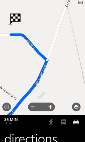

When I tap the address it open Drive+ and shows it. When I tap it on the map it gives two options under About: Address and directions. If I tap directions it opens Drive+ with a starting point. How do I review the list? Ok, I scrolled the map all a way to the destination and it clearly shows a wrong destination point. I wouldn't complain if Google Maps would have been mistaken too, but it works fine. That's how it shows it. Clearly, it is confused. Looks like the map is not completely up to date = useless.

To get the directions list, you tap on the "directions" at the bottom of your screen shot, scroll up from down there and you'll see the listing. Looking at that list could tell you where it is making the wrong turn, and might need to report that to Nokia/HERE.
Is that building you are going to an apartment complex? Look up your directions with the Satellite layer turned on. The pushpin takes you RIGHT to what appears to be the front door. That seems to be MORE accurate than just stopping on the edge of the road / not showing you the building.
I am not sure...But I don't understand why it would mess up the directions by giving you a pushpin that is 50 ft off the road instead of right on the road. I am getting the same result though, (using XX16 as the address number puts the pushpin not on the road, but raised like your screen grab). But the directions do not appear to be incorrect.
Yes, it took me to this building which is wrong. The right destination is on the curve of Suffield road.
