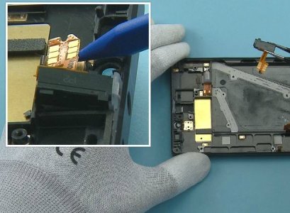

try using a contact cleaner with cotton and clean the 3.5mm hole. the contact points are springy and maybe it has lost its springiness. try to pop the back cover off, see if you can push the contact points outdisassembly0031 (2).jpg from the service manual photo, it doesn't seem like its a serviceable part. but it doesn't hurt to try right..

Tnx for the tip monedetoune. I'll try it tomorrow.
