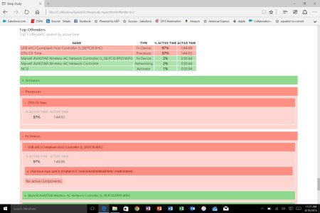

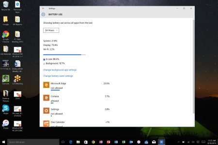

Apparently really no one knows what the issue is now that we have "upgraded" to Windows 10 and apparently I'm not the only person with battery problems.
Fully charged, close the lid, I have even put it into battery saver, I lose 10-15% in 3 hours with zero apps or programs open. This has been going on since I upgraded on the 29th.
Attached are screen shots. I don't have location on. I do not have Cortana on. Basically neutered all the cool things that 10 can do because the battery life is HORRIBLE since the upgrade.
If anyone had the same issues and can tell me what's going on I'd appreciate it. And PLEASE PLEASE don't tell me that I need to, once again, do a fresh install. If that's the case, I'm going straight back to using my MacAir because I'm tired of starting over every time there's an update that doesn't work or upgrade that cannot seem to work properly.
It says in battery report that Cortana is using battery but I do not have it on... Turned it off 4 days ago.
I ran the powercfg/sleepstudy and you can see what's causing this. Driving me crazy.

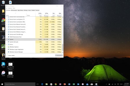

Looked to see what was running. I just pulled my SP3 out of my bag. It's in Airplane mode. And yet, the back is very warm. What in the hell is happening here?
I noticed the two things running constantly and it was using 22% CPU over and over continuously.

I have all the updates and refreshed firmware on my i5/256 SP3. When I took it off the charger this morning, the battery was 100%. After an hour, it was down to 77% doing nothing but browsing a few tech forums on Edge and running Task Manager to watch the CPU. The CPU was constantly 25-40% (mostly System and System Interrupts) even when I wasn't doing anything but staring at the screen. After closing the cover it slowed down, but still using 6-7%/hr.

I rebooted everything, and it appears to have worked, although I am figuring out that Cortana on just kills the battery.
I did three separate tests last week.
1st 3 days with Cortana (and subsequently Location) on, from 100%, closing the keyboard cover, in 4 hours, I went down to 82, 78, and 74%. Nothing else running at all in the background. All apps and programs shut down.
I then shut off Cortana and Location, and under same circumstances, I was at 89, 92, and 96% battery in 4 hours.
I do think it's very strange that I still lost 11 and 8% on the first two tests. I don't get it.
I noticed that System and System Interrrupts were off the charts watching Task Manager and could not figure out why. So I did something I eas told to try a while back with issues when 8.1 first came out for SP3. Holding the power key and volume down key for 10-12 seconds, screen goes black, and keep holding it for a total of 20 seconds. Then power back up.
That corrected the issue of System and System Interrupts killing the battery. I still lose 7-10% battery over a 24-36 hour period but it's far better than the 28-33% I was losing and the SP3 feeling very warm in my bag. Now it does not.
I've found that "Hey Cortana" prevents the system from being able to deep sleep. If you run "powercfg -requests" from an elevated prompt, see if anything is preventing your system from sleeping.

I too was having horrible battery issues after upgrading to Windows 10. I did some poking around the interwebs and found a thread where a Microsoft employee was asking folks to post their powercfg/sleepstudy from their Surface Pro 3s. http://answers.microsoft.com/en-us/surface/forum/surfpro3-surfusingwin10/need-data-from-folks-experiencing-sleepbattery/4748e5e4-a8b1-4b58-bb00-9cc4d1ad9fc3?page=1
After reading through the thread and looking at what people were finding, I was seeing quite a few people seeing issues with their Micro SD card readers. So I pulled my Micro SD card and my battery issues were gone. I can't say it's quite as good as it was with Windows 8.1, but it's WAY better and totally usable now.
On page 9 of the thread I linked above, the MS employee that started the thread did indicate that they're aware of the SD Card reader issue and are investigating so that a fix can be delivered ASAP.
