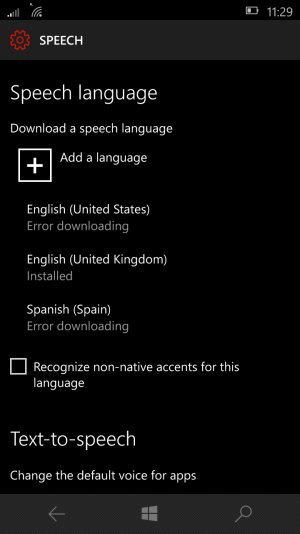

It's only me who's having trouble downloading speech languages on build 10136?
Does anyone know how to solve this problem?

Phone set to location UK, Language UK English, but speech language set to US English. Fails with 'Error downloading' message.
Read somewhere that you have to install the language pack before running Search/Cortana (which fails with a 'Not available in your region' error, presumably because the wrong speech pack is installed.

The only thing that has worked for me is to go back to 8.1, make sure languages are installed and Cortana is working there and then upgrade to 10. Feeling silly because that's what the blog suggested. I just didn't want to have to go back to 8.1 I guess.
To fix this i reinstalled Windows Insider app and then i was able to download the speech and language pack.
This is for people who are facing issues when downloading additional language pack for Speech
Go to Windows Insider app and select Get Preview Builds. Select the type based on what you have currently (I chose slow ring since I that was my initial option) and let it configure. Then, go to the Speech settings and select the language to download. Immediately after this, check for phone update. The language pack will be downloaded here instead of the Speech settings dialog.
