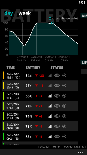

After the most recent AT&T update, my battery discharge rate is frightening. Nothing running, no data and no wifi. Anyone else experiencing this nonsense?

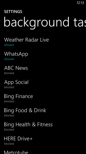

No, I do have Background Tasks running; they are:
...but these background tasks were not changed in anyway for the past month or so.
I meant that there were no active apps running, no wifi, no data connections and no location services when I saw a 23% drop per hour.

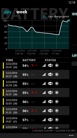

Now, somehow without doing anything different that I aware of, the battery performance overnight last night and today is actually very good, even better than before the update.
Notice how the battery did not drain at all during the night for hours at a time which I've never seen before.
and
View attachment 60219 and View attachment 60221
