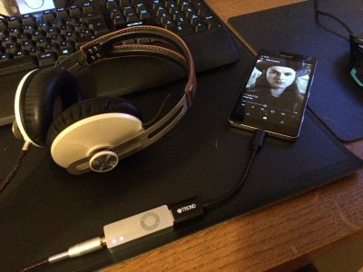

Just to confirm that this DAC does indeed work with the 950.
Sound quality is clearer and louder.
No problems at all, plugged in the USB-C to A adapter, DAC into adapter, headphones into DAC.
The DAC is thumb drive size so its adds no real bulk to a normal phone to headphone set up.
Well done windows 10!
Here is the pic
The two lights on the DAC represent power and also that music is playing @24bit, 96khz.. The latter surprised me a little as wasn't sure the 950 would stream at that level (music in the pic is coming from Groove - it might be the DAC upscaling I guess?).
I went for the adapter that is wired to the USB-A end because I didnt want any pressure on the USB-C in this set up with one of those solid adapters. Essentially the adapter end and DAC just become a link in the cabling (more flexible)

Amazing, it absolutely does not take any space, DAC is really small. I myself listen to a 96Hz and 24Bit .flac

The DAC is the one in the link in an earlier post - Audioengine D3. Here again :
Audioengine D3 Premium 24 Bit Digital Anaolgue Convertor (DAC) USB Audio Amplifier: Amazon.co.uk: TV
The adapter is this one:
TROND? AC6 USB Type C Cable Adapter , For Apple MacBook: Amazon.co.uk: Electronics
I have not yet tested the battery drain over a long period of time. The DAC is usb powered so will drawing from the phone.
Note the DAC also includes an adapter to send the sound to powered speakers, and of course you can also use it on any PC with headphones. I have a very top end PC and it still improves the sound, whilst my wifes mid range PC gets a significant improvement in sound.

In terms of the battery drain using the DAC, it is working out at 14% per hour, so c7hrs of music plating through the DAC on a full charge.
