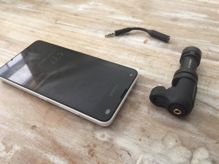

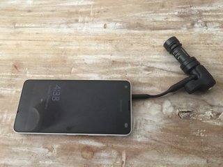

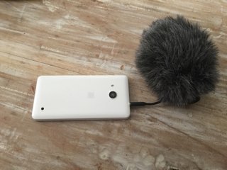

Sorry didnt read your message until now. I'm using the L550, and yes if I try to record video and audio with the mic attached direct to the headphone jack (with and without the dead kitten) it will appear in the field of vision. In fact the dead kitten pretty much obscures the entire camera. Because the 550 isn't my main device to shoot video (my iphone 6 plus is) I normally would only use it with my 550 if I was intending to record audio only - and for that it does a good job.
If you really want to shoot video while using this mic without it getting in your field of vision then I would suggest using some kind of short extension cable and holding it 'off camera'. It's not as elegant a solution because it makes it a proper 2-handed operation - but it isn't too awkward and certainly doable. ImageUploadedByWindows Central Forums1454824414.527602.jpgImageUploadedByWindows Central Forums1454824438.828137.jpgImageUploadedByWindows Central Forums1454824458.464069.jpg
