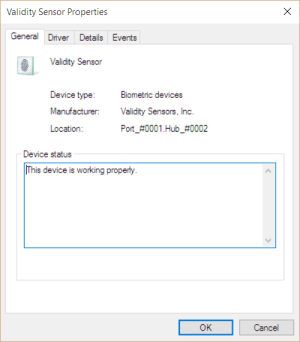

I upgraded my Acer Aspire 8930 to Windows 10. Windows is not recognising the fingerprint reader and I cannot setup windows Hello. Maybe I need to update the drivers but Acer doesn't support my laptop anymore. The fingerprint sensor is manufactured by Validity. Can anyone help with getting latest drivers? Thanks

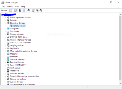

Try going to device manager and uninstalling the device driver (make sure to tick delete driver software for this device) then refresh device manager, windows will try and download an updated driver for the fingerprint reader from windows update. After that, open settings and you should see Windows Hello in there. (that's how it worked on my hp elitebook 8470p with a validity fingerprint sensor. My sensor no longer says "validity fingerprint sensor" instead "synaptics FP sensors WBF")
I tired deleting the driver, but after refreshing its listed as unknown device and the correct drivers don't get installed
how can I know the PID for fingerprint reader?
edit: i got the PID from device manager> properties> hardware ID:
USB\VID_138A&PID_0001&REV_0372
where can i download the driver from?
edit 2: I managed to get the driver and installed it. But I still can't setup Windows HelloCapture.PNGCapture2.PNG
I made an account just to thank you. I followed your instructions and everything worked great. I have a Elitebook 2560p and i used the Synaptics FP Sensors driver update for Synaptics FP Sensors (WBF) (PID=003d) from the Windows Update catalog. I unpacked the driver and right-clicked wbf_vfs_003d_adv.inf to manually installed. Then i went to Device Manager, choose the unknow device (fingerprint scanner) and hit update driver. Chose Browse my computer then Let me pick > Synaptics Sensor and the driver just installed (003d). After that i went into accoutn settings and Windows Hello popped out. I hope this helps.
