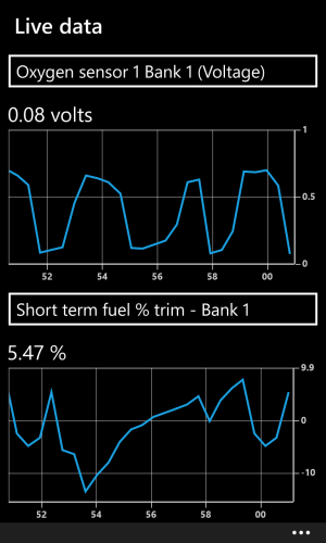

Car Scanner
See what your car is doing in realtime, get OBD fault codes, car performance, sensor data and more!
Car Scanner is a vehicle / car performance / diagnostics tool and scanner that uses an OBD II Bluetooth adapter to connect to your OBD2 engine management / ECU.
Car Scanner was inspired by Torque and OBD Car Doctor (PNN software) for Android, and brings best features of that apps to Windows Phone / Windows 10 Mobile.

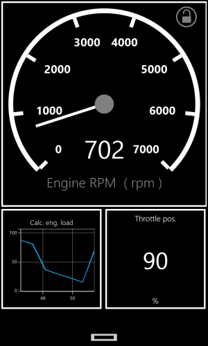

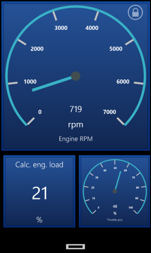

Layout your own dashboard with the gauges and charts you want!

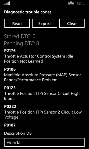

It can also show and reset a DTC fault code like a scantool. Helps you fix your car and helps keep repair costs down!
