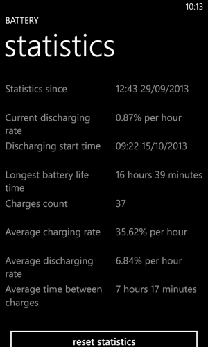

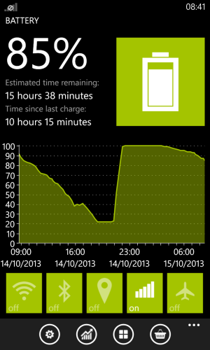

I upgraded my Lumia 1020 to the preview yesterday. I left my phone off the charger overnight and woke up with only 3% drain over 7 hours. Also, the current usage rate is 0.87%
Is the battery reporting screwed or has the performance really improved?
I have 3 email accounts syncing every 30 minutes, glance on peek and double tap to unlock. have a bunch of apps with background tasks enabled (battery, bing news, bing weather, caledos runner, das image, whatsapp)

3% battery drain in 7 hours?! wow, that is impressive with all that background things going on! I get 3% (at best) in an hour just sitting idle with dgr2! Tempted to download gdr3 now!
