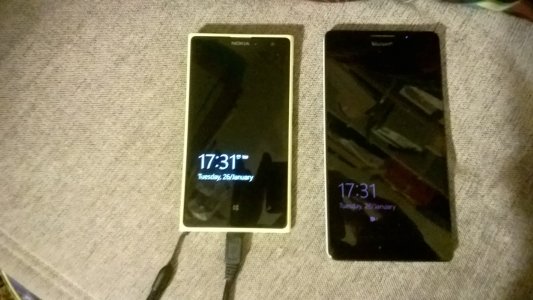

Can you post a picture of your phone with the Glance screen ON? Just making sure our "not-normal" and "normal" are on the same page.
WP_20160126_17_31_25_Pro.jpg This photo doesn't show clearly how much difference there is between the two. I can "glance" at my 1020 sitting on the wireless charger less than one meter away in my apartment and see the time clearly. I can't do that with my 950 XL. As I said earlier, I have to turn on the lockscreen to see the time when outdoors. Never had to do that with my other Lumias.
View attachment 126869 This photo doesn't show clearly how much difference there is between the two. I can "glance" at my 1020 sitting on the wireless charger less than one meter away in my apartment and see the time clearly. I can't do that with my 950 XL. As I said earlier, I have to turn on the lockscreen to see the time when outdoors. Never had to do that with my other Lumias.
is there some kind of screen protector over the screen? It isn't covering the light sensor, is it?
Now that I look at both the pics carefully, I do remember having my 1020's Glance screen being brighter than my 950XL. In fact even the 925's Glance screen seemed to be more or less like the 925. Having said that, the 950 XL's glance screen is still readable on my device and it looks the same as yours.
