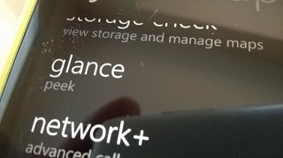

What's that you say? Sign me up?
Well then! You can find it in the settings list.
(not necessarily in this order)

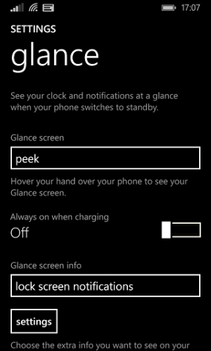

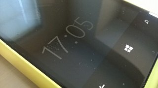

And now back to our scheduled guide! Here is what the Glance settings panel looks like on my 920. (equipped with Windows Phone 8.1, and the Lumia Black firmware. Don't ask me about Cyan, because I don't know, and there are threads for you elsewhere.)
The first option has four settings:
  • Off
  • peek
  • interval
  • always on
NOTE:
  • Glance makes heavy use of the proximity sensor. (that thing that knows when you have your phone up to your head during a call, on my phone, the Lumia 920, it's located in the upper right, above the display. If Glance isn't working for some reason, make sure your proximity sensor isn't obstructed.)
  • In peek mode, waving over the proximity sensor reactivates Glance, so you can check the time, and with the Lumia Black firmware (sorry 810 users!) you can see your notifications as well. Flip the phone over or put it in your pocket? The proximity sensor knows that and doesn't turn on Glance, saving power. Flip it back face up or pull it out of your pocket? It's back. This applies to all modes.
They are fairly self-explanatory and have good descriptions when selected.
  • Off is, well, off. Your Lumia behaves like any other phone when turned off.
  • Peek, my personal preference and what I recommend, displays the Glance screen for several seconds (with recent updates after this guide was written, it is now 30 seconds) and shuts off the display after that.
  • Interval turns it on for 15(?) minutes, regardless of your waving. I believe blocking the proximity sensor turns it off.
  • Always On, is well, always on. It still heeds the law of the proximity sensor however.
Always On While Charging: Self-explanatory, this used to be default behavior, but I'm glad they finally added a toggle. I used to put an earplug or paper over my 920's proximity sensor to turn off Glance when charging. (flipping it face down on the wireless charging pad isn't an option, and it already slid off my desk a couple times before early on.)

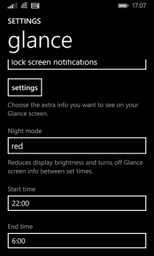

Night Mode:
Another feature is the night mode. It disables the brightness further, turns off the Glance screen info as described above, removes your background (will be described shortly) and sets Glance to one of three colors other than white. (Red, Blue, or Green) I personally prefer red since its the warmest. You can also have it off at night with a recent major update to Glance.
And the start and end times are self-explanatory. If you love or hate night mode, you can set it to be active as long or as short as you like. Doesn't look like you could completely turn it always on or off though.

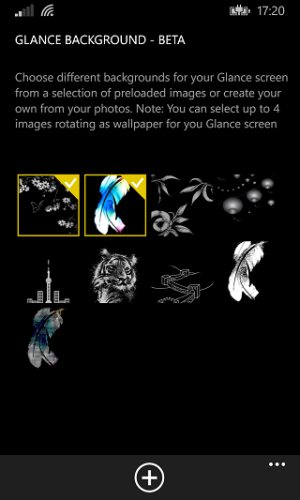

Backgrounds:
Yay, more personalization options! Glance Background is a separate app (link to it's Beta Labs page is in the Additional Links sections, the direct Store link is: Glance Background | Windows Phone Apps+Games Store (United States) )
This app allows you to set up to four rotating wallpapers (see http://forums.windowscentral.com/nokia-glance-backgrounds/ for some nice ones) to use on your Glance screen. You toss in a picture by hitting (+) and can put that picture through some effects by sliding the bar at the bottom. (You'll know what I mean, and in the picture, you can see multiple effects applied to the feathers image I use)
On LCD phones, backgrounds don't really affect battery life much since the display is all lit anyway, but on AMOLED displays, the more pixels lit up means more power is used, may not be significant if its a simple picture, but if its a full HD panorama of the Sistine Chapel, battery life might suffer.
Also worth noting that with recent Glance updates, the option to use your lockscreen wallpaper as the background in Glance has been baked in.
