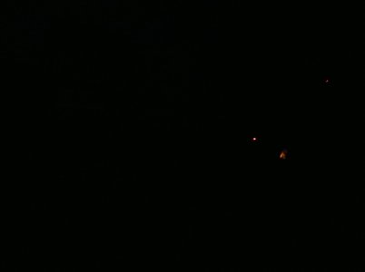

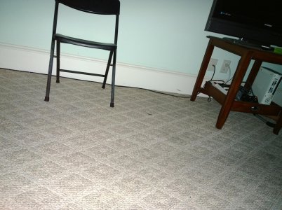

Need help under low light conditions
I saw in the videos that we can take pictures without flash...but i'm unable to get any pics...it's dark . Just want to know what i'm doing wrong. I'm able to get pics with flash though...

Your basic problem is exposure. The EXIF of the photos are gone, so I can't comment on that. But anyway, regardless of the device it is exposure.
What you can do is set the 1020 to Auto exposure, or if you're using Manual mode, bump ISO to say 1600 and set your Shutter to say 1/10, Aperture to f/2.8 and let OIS help you.
Now that is odd for Auto exposure. Can you try the settings I posted instead, and let's see how it does.
It will be unwise for me to put blame on the device without actually looking at it, so I guess my help will end here. If you have another device to shoot the same scene I believe you will get my point regarding the exposure, and will validate an issue with the 1020.
ps.
Can you change the Scene mode to Night?
Im going to guess that based on the first picture, you are actually trying to take a picture of a completely dark room which his camera will not be able to do. Try the same picture with some sort of soft lighting such as a laptop screen shinning out towards your subject. then set the ISO to 4000 and the shutter to 4s. That will be the brightest photo you can take (thougth extremely grainy). Then work your way down in iso till you get a quality that is acceptable to you. Its best to use a tripod when shooting stuff like this and even using the shutter delay will help reduce camera shake caused by physically touching the screen or shutter button.
There is difference between low light and no light at all. :smile: Even indoor areas with just sun light casting through windows are consider low light situations.
You can try settings shutter speed to 1/4 or 0.3sec and leave ISO setting auto. Make sure you have steady hands even with help of OIS, since shutter speed is prone to blur photos on those slow speeds. Slow shutter speed allows to shoot lower ISO, meaning less noise in photos and more details visible. Those slow shutter speeds are good only when there is no movement in your scene. Then you can adjust exposure by using EV slider to get it right.
If your photos seems to end up blurry, raise shutter speed when no blur is visible any more and leave it there.
