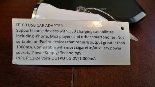

My problem was my car charger did not put out enough amps. Using a power sucking Note 3 right now.
Look for one of the heavy duty ones that will charge a tablet or iPad. Should be about 2.5 amps.
Here Drive does take a lot of power (it has to do a lot of calculations) but in my experience a good car charger can keep up. And that's probably where your problem comes from, your charger can't deliver enough power, you'll need a heavier one. The lighter chargers only deliver 500mA, you'll need 1A at least.
Here is the tag from a charger my company uses for a give away.
It will NOT keep up with my Note 3 if I am using it for turn by turn directions.
Not sure that accurate. I have a standard car charger and have a 2A usb that supports 2 devices. Charges like a champ. Get a USB that has a 2A rating and make sure you either use the USB cable that comes with the phone or buy a quality one.
