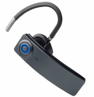

I love to use cortana handfree most of the time especially using a bluetooth headset. i hope to see bluetooth headsets with dedicated cortana button to activate cortana, so that even phones without "Hey cortana" can activate cortana just using their bluetooth headsets and can interact with the phone. Microsoft band has a button to activate cortana but we cant listen to cortana using that. But i am not sure if it is possible to activate cortana using a bluetooth headset.
