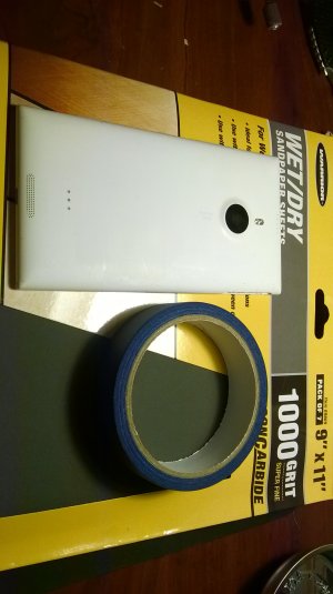

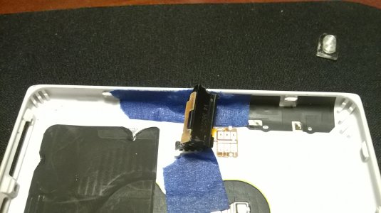

We start with an ugly cover, masking tape and some sandpaper.

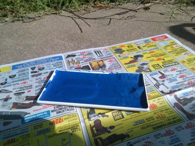

We then tape up the holes and cover the camera lens.
Now we rough up the surface and smooth out any bad patches.

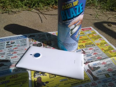

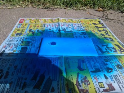

Time to head outside! Remember to use newspaper, I wouldn't want your wife to kill you in your sleep.

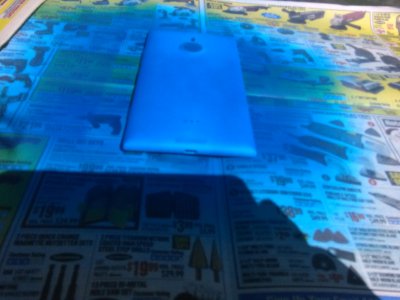

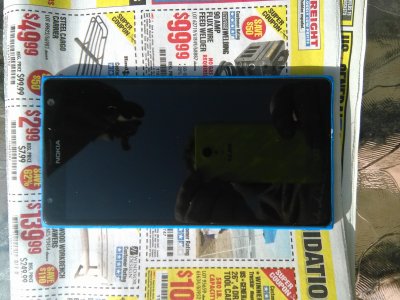

Plasti-Dip goes on much like spray paint. six to ten inch distance. Thin coats with a thirty minute dry time between coats. Don't forget the front of the phone.

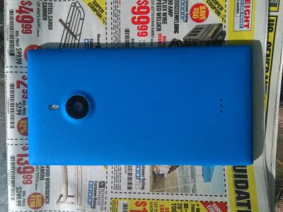

I did five thin coats here, and I will stencil something later, but there we are. Nice rubber coating that makes the old warrior handsome again and slip resistant. Best of all when I get bored of the color I can peel it off and go with another! (yes I see the bit at the bottom where the dip stuck to the paper, not going to sweat it.)
I like it. It's not quite as nice as an actual cyan cover but that's never happening...so good job haha.
