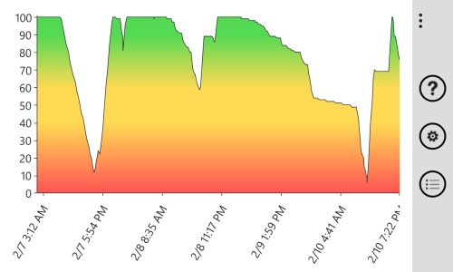

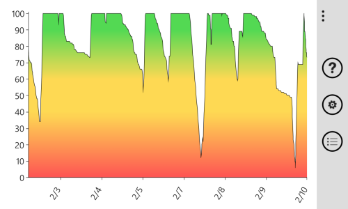

So I've had the phone for 2 weeks now, and I have gone through literally every range of battery life. At some times I've gotten estimates of 3 day battery life, and have taken photos and played games constantly throughout the day... at other times like today my phone looses 25% in 1 hour and all I've done is rearrange live tiles and used the internet to search for what the heck my battery problems are from. Then just a few minutes ago that estimate jumps up from 5 hours to 12 hours for absolutely no reason, there are no apps running in the background (atleast not that its letting ME SEE) and I have Bluetooth off, wifi off, tap and send off, email synch set to 2 hours, location off, brightness on low, and all backround tasks disabled (that I CAN DISABLE) and the phone is completely up to date. I have no idea what to do, at some times I absolutely love this phone, but then every once in a while I take it out of my pocket at 7 in the morning and only have a quarter of my battery life left... I have heard some people saying that you need to cycle the battery (I have no clue what app to use in order to do this) so maybe its just giving misestimates. I also might add that the problem seems to have nothing to do with the heating issues. At some times after wirelessly charging I have a hot back, but extraordinary battery life, at other times I have a cool back and horrible battery life, and at others the thing is burning up in my pocket with nothing running and is draining my battery like heck. I attached a picture below just to show a short-four day-or-so span or my battery life showing the various extremes.

first you must understand how battery measurement works. Then according to your describe, your phone should last about 9hr average, which I think its ok to see a quarter left at 7pm. According to your graph it seems like average 12-14hrs, pretty good I say.

Your discharge rate looks like the GPS is stuck on - I only see what you are getting when Nokia Drive is running hidden. Make sure that is not set to run in the background. (IMO it's kind of stupid that it uses GPS when no route is active... but it does.)

No I mean at 7AM, as in I get it fully charged at night and after doing nothing its gone by morning. Also The problem isn't the averages, as yes on the whole I get good battery life... but then there is those days like today where I get a top of 7 hours without being able to do anything on it besides check the time.
... For nokia drive... I don't think I have ever actually opened that app, however, I did turn the background task off today and hopefully that might help. So far it doesn't seem to have changed anything, but i'm going to keep checking.

Uninstall Nokia Drive first and foremost. Next, fully charge device and perform a hard reset. It sucks, but it fixed mine. It took me 3 months to get good battery life. 12-14 hrs is about all you can expect on LTE with moderate use. Don't even pay attention to expected battery life meter until you have about a month of using phone. People who say they can go 2-3 days on one charge aren't using LTE or don't use their phone. Trust me, I've asked. You either have a process hanging, which soft reset should resolve, poor lte coverage, or you are using phone a lot. Also turn off connect for Xbox games. Gmail sync has also been an issue. Process of elimination. See what works.
