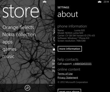

Your phone is most likely "branded" in that sense that it has carrier specific firmware. You can check this in the 'settings / system / about' page. Third line down against carrier it will show what software variant you have - I suspect EE. Unbranded phones have a CV GB SW Variant; but officially these are not (yet) available in the UK unless you flashed it yourself.

Check your marketplace. If you have T-mobile apps - it's Tmob branded. Unlocked phones don't have that operator apps section.
They do, it detects which section to display based on the sim card. My unbranded UK 920 has Orange Selects for example.

That's very strange. My unbranded Titan and Lumia 800 both from CPW, never showed operator marketplace. I was with Three and O2

I have a Nokia Lumia 920 and have been looking to get a 930. There's one that looks good on ebay (can't post a link, this is only my 4th post) but it says it's locked to the EE network. Now, I have a T Mobile SIM card and that is now owned by EE, right? And there is an EE H symbol near the top when I go to my notification centre.
So, I figure I'll be OK but, just to check, I go to the About screen through Settings. Next to Carrier it doesn't say EE, it says CV GB. This is confusing. The Ebay pictures of the phone has "Carrier: EE" on its About screen. Do I need it to say Carrier: EE instead of CV GB for this phone to work with my T Mobile/EE SIM?

CV means Country Variant, it's unlocked for use on any compatible carrier worldwide.
