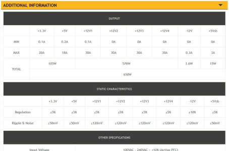

On most power supplies there's usually a graph on the side that shows output drop under load.
Here's the particulars for an Antec @ 650 watts:
I'd say a good quality 600 watt PSU should handle anything you're wanting to do.
