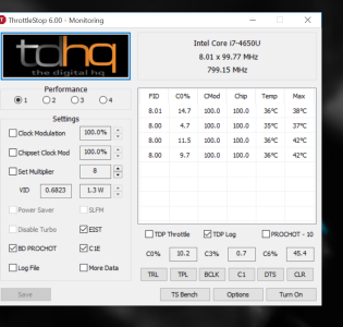

Download throttlestop (you can look for it on bing)
And then disable turbo boost, it is the bane of the surface pro 3 and adds no real benfits apart heat and slow down, you could then overclock it to 2.0 and it will stay around 70c, mine is around (55c to 65c) 1.9ghz never hear the fan, not even when gaming or designing

I forget about it being not Plug in now, and last for a good 6 to 9 hours, with using PhotoShop etc, and performance is better then ever, no slow downs and I can use it as a tablet without feeling like my hands are going to burn

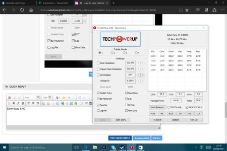

I download "Throttlestop" and i'm running it now. How do i disable turboboost and how to I over clock it to 2.0? Thank you very much.
One more question. Attached is a screenshot of the stop throttling software I downloaded want to make sure this is the correct one. 2nd when i close it the program closes all together and I no longer see it running in the task bar. Does this mean Throttling is back on if I close the app and I need to load the app every time I start windows?
I downloaded v 8.00 beta 2. I don't have the batt 100% option nor can I check the Prochot 90C box. Also Mine says C1 and not C9. I'm definitely interested in this.
