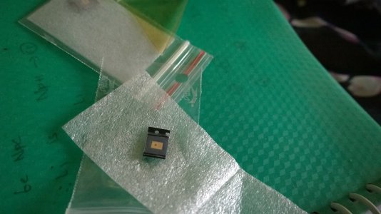

update: just received two new microphone which I ordered on ebay,seller claim they are original unlike Chinese..some thing wrote on them unable to read as letters where very small...shall I take to local store or shall I try to repair my self.?

1) I don't know how to identify....i'm still in trouble :( I got two original mic(nokia care guy conformed).
2) partially..before repair: on windows 10: no sound for recorded video(playback),while on call if we use loud speaker other end can't hear us,no voice recording.....after repair: on windows 10: can hear sound for recorded video(playback) but only on right side(I mean if we playback recorded video using headset only right ear can hear sound where as on left it's mute), still other end can't hear my voice,no voice recording.

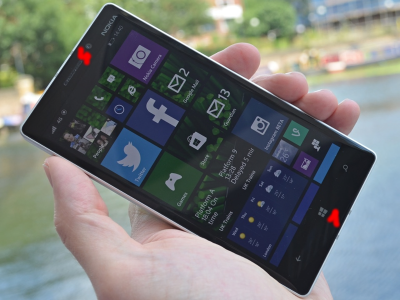

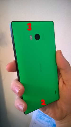

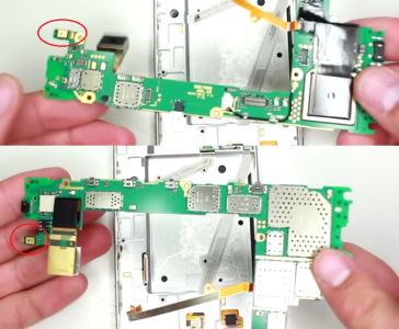

there are four mic: front bottom and back bottom are flex mic, front behind ear plug and back top are on board mic....I changed both on board mic according to nokia service guy he say one of the new mic is broken...according to one guy or some fellows ( both on board mic's are 3 & 4) and both flex mics are 1 & 2..after repair I think 3 mic's are working where as one doesn't I don't know which one is culprit...Lumia test application just waste before repair it said 3 & 4 are fault after repair it says same pheww.
some how I want to check:
1) are two flex mic are fine?
2) does one of two new mic is broken?
that's where I stuck right now..
below images are from other users who claim they know which one is culprit.
