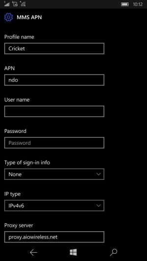

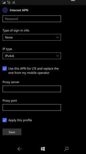

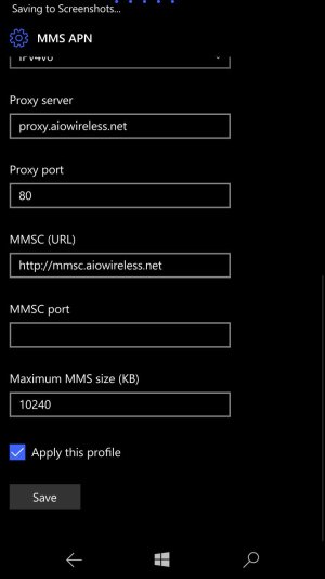

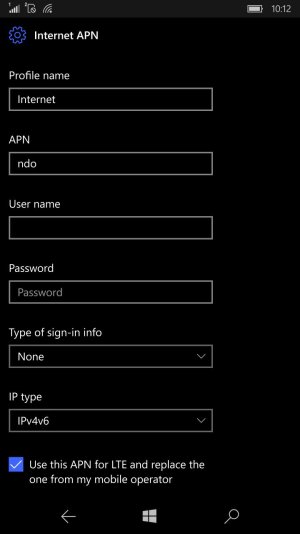

Just got the x3. I had Verizon, switched to cricket. They can't seem to get picture messages to send. I tried several sites, always says it can't send. Txt works good. I updated the phone and don't have any beta or fast ring. I installed all updates i could find.
Have any of you found out a better SD card to use? I have a 32g sandisk. Every windows phone ive ever had with this kind of card boot up and state "THERE WERE ERRORS FOUND do you want to reformat the card?" (something along those lines). Now with my HP ELITE X3, it kicks it out randomly and I have to pull the tray out and put it back in, restart as well. Is there a better SD I need to be using for this phone and OS?
https://apn.gishan.net/settings/1477_22_cricket_apn_settings_for_hp_elite_x3.php
Those are the settings I'm currently using. Still can't get pictures to send : (

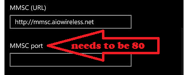

Same as the site said except change these...
  • MMSC Port: 80
  • Maximum MMS Size: 10240
https://www.cricketwireless.com/sup...d/customer/bring-your-own-windows-device.html
There is. I had it activated there. They gave up trying to make it work. However they did take pictures of the phone box and phone.
I'll swap my SIM into a BYOD on Cricket and take some screen caps of my settings for APN/MMS and post them.
Likely tomorrow morning.
I was able to send my first picture today. I hadn't changed anything since the last time I tried. Not sure why it is working now. I will post all my settings.
