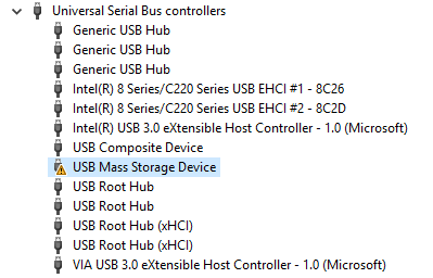

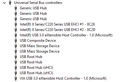

hmmm I posted before I rebooted LOL
Thats the image I posted BEFORE the reboot
Now after reboot, this is interesting...
I have a exclamation mark next to one.
I did do a "update driver"... but got told im using the latest one LOL
This device cannot start. (Code 10)
{Operation Failed}
The requested operation was unsuccessful.
In properties of the drive.
I unplug it, and plug back in, and it shows all fine
{Operation Failed}
