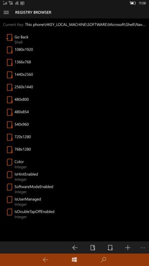

Where did you find these registry entries at? I have searched everywhere that I could think of for the never option on the lock screen and never found it. I did find the same DttW entry that won't let you change the value (remains at 0), but I never actually got the toggle to show up. Where did you find that one at?
Last option
FYI, that option from your screenshot IsDoubleTapOffEnabled I am pretty sure is for the double tap of the navigation bar to turn the screen off.

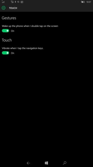

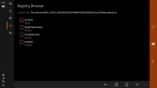

Try here to see if DTTW shows up. You may need to add the entry "Enabled", then edit it
Well I did get the toggle to show up in Touch now (thanks!). So now need to find the entry to actually enable the DTTW. I think it might be in HKEY_LOCAL_MACHINE\SYSTEM\TOUCH\Settings\FF and entry EnableWakeupGesture. It's set to a 0 currently, but I can't overwrite the value. I have tried multiple times and if I do it from the Registry Editor section it says error writing value.
Yeah, I've tried editing all those entries but no luck. They're not available to edit. I believe those entries are locked down still.
