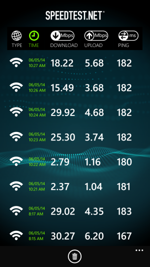

I did a speed check on both 2.4GHz and 5.8GHz and the difference is negligible. If I go to my daughter's room, then I can't connect to the 5.8GHz, but that is understandable, because 5.8GHz does not have the range of 2.4GHz nor does it have the wall penetration capabilities of 2.4GHz. I'm running a 5.8GHz because of the amount of interference I was getting on 2.4GHz as well as the increased throughput. One of my neighbors moved out recently, and I've noticed a considerable decrease in interference in the 2.4GHz band. I'm wondering if he had a cordless phone that was causing the interference. I'll have to do some more experimenting again.
The 30Mbps download is the 5.8GHz network speed. I'm paying for 25Mbps, so I can't complain.

Ok. So I walked around my house both upstairs and downstairs. I found that I can't connect to the 5.8GHz network in my garage or my daughter's room. No surprise there since 5.8GHz doesn't have the range of 2.4GHz. I can connect to my 5.8GHz in every other part of the house and have good speed. I then switched to my 2.4GHz network and got good connections everywhere in my house and garage. My worst speed was my daughter's room and garage, which again is no Surprise given the distance and the number of walls the signal has to go through. I also connected to the 2.4GHz repeater we have upstairs and again, had no problems connecting and had decent speed, even in my daughter's room.
So for me at least, I'm getting the reception that I should be getting. I'm running 8.1 with the latest update as well as the new firmware that Verizon pumped out for 8.0. I have a higher end Netgear dual band wireless router as well as a Netgear dual band repeater/bridge (2.4GHz repeater/5.8GHz bridge) upstairs to connect my desktop to my network.
My range of speed was just over 30Mbps on my 5.8GHz network all the way down to 2Mbps in my daughter's room and garage on the primary 2.4GHz network. With the majority of speeds between
