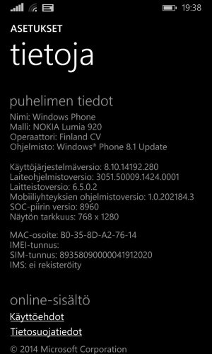

I'm on DP, so I have latest firmware. After the downgrade didn't solve the problem I upgraded again.
Don't necessary means that you have latest firware. DP is for software not foe firmware. Use nokia tool to flash cyan, after install do hard reset, start over - do not use old backup. Don't install DP updates, and let batery stabilise for few days. If reboots and battery drain continue, you have hardware problem. Maybe battery just reaches it end of life or there is other problem, but do above first.

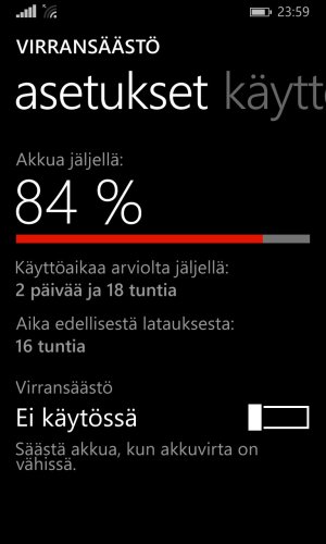

2 years old Lumia 920 has a great stand-by (idle) with the latest DP 8.1 update 1 (just minor use during that time, but battery usage 1 % / hour) - with wi-fi and location on ...
