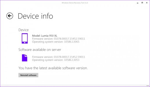

Lumia 950 XL Unlocked Variant UK, non insider running 10586.29. The firmware update package doesn't appear to be available yet. Using WDRT, it shows the available firmware version is the same as what's installed on my device currently, even the software (OS) version available is a couple of revisions behind on the server (likely 10586.0/11). Unless WDRT shows it available you won't be getting any Windows Update notification yet, no matter how many times you smash that "Check for updates" button.

Just for reference, WDRT makes web requests to the following locations:
api.swrepository.com
softwarerepo.blob.core.windows.net
If the firmware package isn't on Microsoft's servers, don't expect an update notification coming just yet.
If the firmware package isn't on Microsoft's server, don't expect an update notification coming just yet.
Not completely true. There are cases where the software version on the WDRT server is older than the latest firmware which can only be installed OTA (Lumia 920 from Rogers CA and Lumia 925 from LTA MX CV are the known examples).
Fair enough. An exception to the rule in this case, but as Microsoft themselves stated, this is a staggered roll out, so the fact its not appearing on CV UK devices, doesn't surprise me.

Because on WDRT builds are not updated as frequent as OTA updates, only few times a year, it's for recovery purpose.

I ended up using the WPDR tool to go back to .0 then installed Windows Insider, update finally found .36. After install, I reset my phone and restored the backup I had from .29.

ok I am confused....I just connected to the recovery tool ad it found software on server. I proceeded to download and install the software and the phone reset. Now I am showing 10586.0 and firmware 29005??
Just checked the updates and .29 is there ready to download but is the firmware right? The recovery tool says it is up to date??
What device are you using? My 950xl is showing - 1078.00027.15506.02008.
Which firmware is the most current? Is it possible to revert to the older firmware where the .36 update installs?
