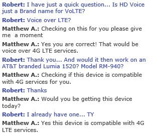

Yes...
HD Voice is an AT&T brand name for VoLTE (Voice over LTE).
I just chatted with Matthew.

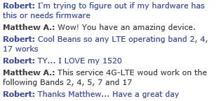

There are only a handful of phones that are supported with software and hardware for VoLTE at the moment. 1520 not one of them.

the rep did not answer the question and no the 1520 does not support HD VoLTE. Also feature must be deployed in selected markets to work- and must be using compatible device for both caller and receiver. iPhone 6 was touted to have HD voice calling as well as the newer Samsung Galaxys and HTC ONE M8 Windows. I havent read anywhere that Nok Lumia 1520 was capable of it.

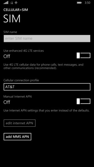

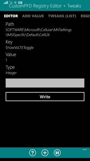

Its actually there in the settings, but hidden by the registry. I will play around with mine and see if I he HD working
Re:
Just to follow up, I was able to get it to show the VoLTE toggle but I can't actually get it to turn on. See attached pictures. If you're wondering my method, its the old Windows Insiders app proxy trick that was patched a few weeks back. I have purposely not updated the app, so should be able to continue writing to the registry if there are other keys you guys want me to test
