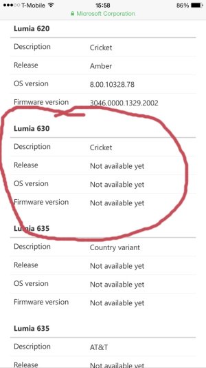

I have a Nokia Lumia 630 and I have seen everywhere that the Denim update has been available for my phone. It has been updated already and the update is not on there. I have been wanting the enhancements to my audio and I checked yet they are not on there. I heard the denim update would fix that problem but I don't have it yet I am in the United stated and my phone is qualified for the update. Help???

Preview for developers will only give you early access to your operating system example windows phone 8.1 and not your firmware example Cyan, Denim and so on. But as mentioned above your carrier has yet to start releasing denim to your device, its worth it saving the link from the picture posted above and check back on regular intervals to see.
