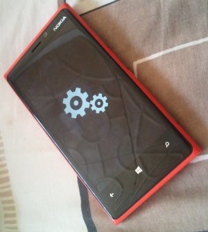

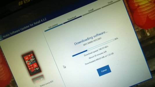

After going back to WP8.1 on my L830. I decided to upgrade my L920 to W10:TP. When installing W10:TP on my L920, I was on it's 2nd phase on the install and I thought everything was going well. Now my L920 keeps going to the gears (with the status bar not even moving) and restarts with the nokia logo and at&t logo and back to the gears and so on. I tried using the Nokia Software Updater for retail (Ver. 4.3.2), but doesn't recognize the phone (even when rebooting the phone). I also tried using the WP Recovery tool, but that doesn't work as well. Should I have wiped my phone completely b4 doing the upgrade?
***UPDATE(06.29.15)*** I figured it out. I ended up using a different USB cable and it recognized my phone when I was running the latest version of Nokia Software Updater for Retail (Ver. 4.3.2)
