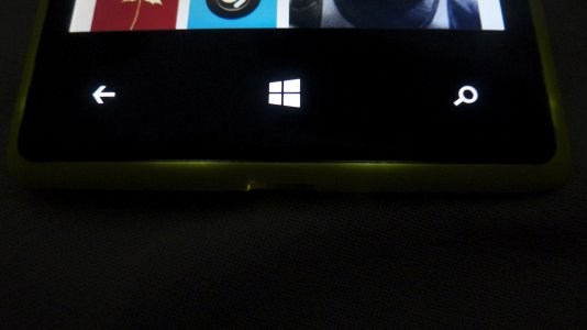

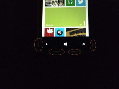

Hi there dear 8X owners. :)
There is light shining through the case at the bottom (where the soft buttons are). Its shining through the case at 4 different spots (see attached photo). The light actually is stronger than it is in the photo, but you can see the issue.
I have noticed that my 8X is a little little little bit thicker on the bottom than it is on top.
Are you having the same problem?
Thanks in advance
That indicates that your screen has seperated from the case a fair bit. Probably more than I would feel comfortable with. I would return it if you are within your return window with your carrier or contact HTC for a repair.
All three of mine did that. I don't see a real problem with it though. I don't think mine are as bright as yours though
